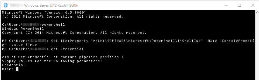

Hi @Mike_D
There’s a regkey you can set to allow you to enter credentials without the pop up.
Set-ItemProperty "HKLM:\SOFTWARE\Microsoft\PowerShell\1\ShellIds" -Name "ConsolePrompting" -Value $True
You can set it back to normal with $False when you’re done.
Very nice!
Thank you
