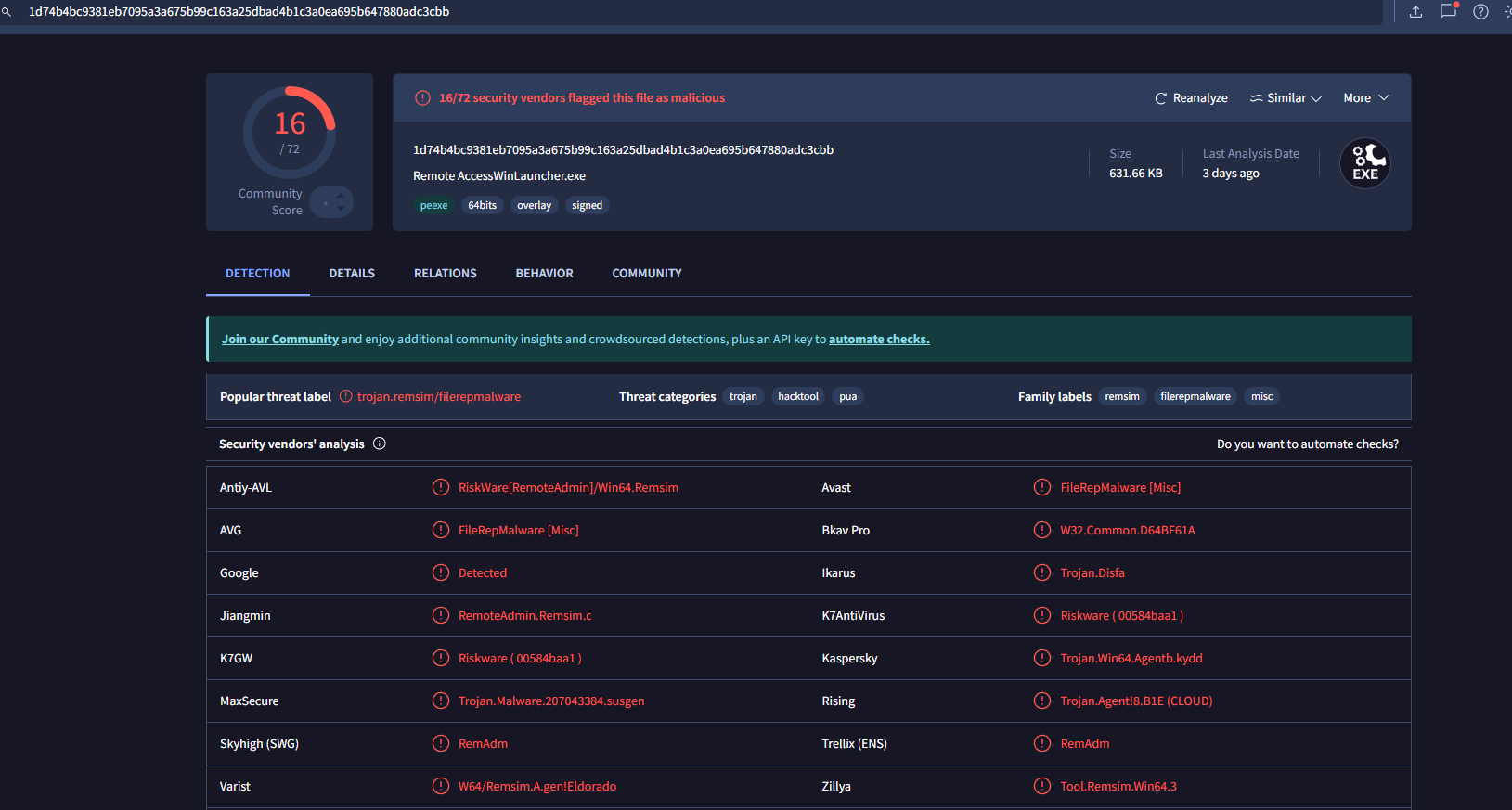

Guys, this isn’t a matter of swapping out IPs, DNS, or even an ISP issue. Over the past two days, the situation has worsened significantly. The SimpleHelp executable, RemoteAccessWinLauncher.exe, with the hash 1d74b4bc9381eb7095a3a675b99c163a25dbad4b1c3a0ea695b647880adc3cbb, is now being flagged as malicious more widely. This is triggering alerts across several of our EDR/MDR partners and has become a major problem that urgently requires attention from SimpleHelp support. Unfortunately, support has been completely silent on this issue.
I’m unclear on the specific resolution—whether a new executable with a different hash needs to be published in a new release—but something must be done immediately. I believe this issue will continue to escalate if left unresolved.
I’m not sure what they plan on doing about this, but it is of CRITICAL CONCERN
If they can’t find a solution we may have to revert to using another product because this issue is hindering our ability to support systems.
And we love Simple-Help. PLEASE RESOLVE THIS ISSUE ASAP !!!
The number of platforms detecting it has now jumped to 24 over 16 when posted the other day…

How has the topic gotten confused? While it may have initially seemed like an issue related to a specific IP address or ISP, the underlying problem appears to be that SimpleHelp.exe is being flagged by multiple ISPs and EDR/MDR platforms as malicious or malware. These two issues are not necessarily mutually exclusive—they can be, and most likely are, connected. This has been corroborated by authoritative sources such as VirusTotal.
In our case, the problem became evident after upgrading to versions 5.5 and then 5.7. In early December, our SimpleHelp servers and clients were completely blocked. Initially, it seemed isolated to our ISP, but further investigation revealed the root cause was our MDR platform. They informed us that VirusTotal was flagging the executable file, and the hash for the file is consistently being identified as problematic.

We have both Fios and Spectrum in our area, and we’ve seen this issue occur with both. It would be logical to think that if an .exe is being flagged as malicious on online platforms like VirusTotal, the ISPs would follow suit in their attempts to prevent the spread of what’s perceived as malicious activity. As a result, they are taking these precautions. It’s also highly likely that one or more SimpleHelp installations somewhere in the world have been compromised, using SimpleHelp as an attack vector, which is why the hash is being flagged as malicious. At this point, it’s likely become a domino effect and hence they are related.
One of the things you will see in Virus Total is the IP addresses that are being associated with the simple help executable, which can turn into IP blacklisting,… I for one would like to keep MY IP addresses off of those lists, and this is putting them at risk.
